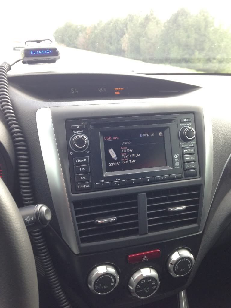

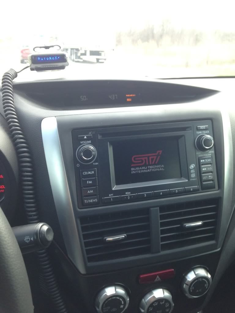

    Haha well that certainly got my attention. So I have had this new radio for about a month and have a few impressions.
    Pros:
    1. Cheap and easy. It was far less expensive than a true aftermarket head unit. It was also super easy to install, took about 10 minutes to do by myself. It really is plug and play and retains all steering wheel controls and center console USB/Aux audio.
    2. Factory look. I think it really adds to the interior of the STI, all 08+ WRX/STI should have come with this simple upgrade.
    3. Easy to navigate. This is the main reason I picked this radio. 99% of what I listen to in my car is either from USB or Bluetooth from my phone/iPod/USB drive. This larger screen makes it so much easier to navigate everything and choose what I want to play. It also keeps my eyes on the road better than looking down at the phone in my lap to look at music.
    4. Hidden menu really improves the sound over stock. Again, if you do a quick search for this radio you will find a few threads on how to turn off the factory EQ and Loudness settings. This really balances out the sound and is a definite improvement over the stock radio.
    5. Option to set a screensaver. After 10-15 seconds of not touching the controls a screensaver will come on. I like it as it is less distracting than the song info.
    6. Ability to set brightness for both day and night. This was really nice, you can set the brightness and contrast exactly how you would like for both day and night. Day settings are active when headlights are off, night settings are active when headlights are on.
    7. Ability to add backup camera. I thought this was pretty cool. Any camera worth a shit though is ~100 bucks. SVXdc makes a harness for this radio that works well with aftermarket cameras. If I were to do it I would go with a Rydeen MINy as it is the easiest to wire. I just can justify it right now as it is pretty damn easy to just look behind you when you back up.

    I would say it was in "new" condition. When I ordered the seller messaged me back stating there was a small amount of glue on the unit. I requested pictures. They sent them and I asked if I could get a small refund or free shipping since it wasn't as described. They offered to send me some cables and knocked off half of shipping. I agreed. You can see the glue in the above post pictures. It is above the eject button on the top left. Not a big deal to me, I have some industrial solvents at work I will probably attack it with. Other than that, yeah the unit is perfect, no damage or scratches on the screen.
